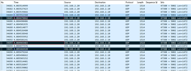

    I ran iperf3 with the above settings.
    A part of the capture at that time is as follows.
    Occasionally a periodic burst of frames is seen every 500 us.
    However, there may be about 1000us frame interval once every few times.
    How can I see a periodic burst of frames every 500 us?
    Do I need to change iperf3 settings? or Do I need to enable IET FPE with MAC Verify?

    In general with Ethernet interfaces once you enable an interface there is a delay of a second or maybe more when the Ethernet level auto-negotiation completes. So I'd suggest in general you have a sleep 1 or longer after executing interface up. You will see a printout in the standard console (serial port) that the link is actually up.
    I'm guessing you also ran the tc filter to force the UDP port used by your iperf3 command to use one of the queues you setup? Can you show the tc filter command and the iperf3 command. Basically how many frames per second is iperf3 asked to generate.
    What EST does is close gates for traffic to get on the wire. So EST guarantees that traffic using a given HW queue (often mapped to VLAN PCP priority by the user) does not show up when gate is closed. If frames show up when a gate is open is a combination of packet being sent (iperf3 in your case), and gate being open. The schedule set is 500us period (125+125+250), so packets packets showing up n * 500us is as expected. iperf3 in UDP tests produces frames in bursts to try to meet the rate you asked it to create. It does not create a smooth rate of 1 packet per say 500us, rather it tries to meet the rate ou requested over a longer period of time. The gates you have configured are open for 125us or 250us, so multiple packets will fit on the wire at a time and the avarege can be met even if there is no packets in one 500us period.
    No. IET is the acronym for the feature preemption, and MAC verify is a feature related to initializing preemption. EST is the time aware shaper feature in TSN.
      Pekka
    I was able to understand the function of EST.
    It was confirmed that the frames stored in each queue are no longer sent at the specified timing.
    Q2: UDP Port 5003 (125us)
    Q1: UDP Port 5002 (125us)
    Q0: UDP Port 5001 (250us)
    I solved all my problems of EST
