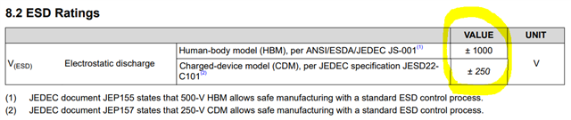

Hi
What is the ESD immunity of the DRA821?
The DRA821 seems to have low ESD immunity.
(For example, that's about half the AM3352.)
What factors affect ESD immunity?
Thanks and Best regards,
Tsurumoto.
  • Hello Tsurumoto-san,

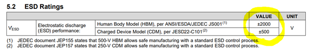

    It may just be the conditions that the different parts were tested in.  The value in the DRA821 datasheet matches J6, and is the standard methodology used by Jacinto processors and meets auto requirements.
    Even the AM335x device has this footnote:

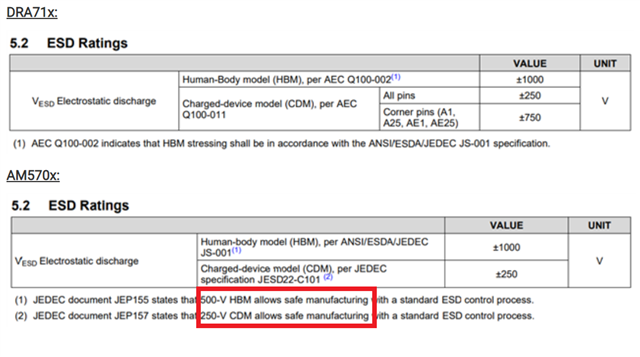

  • Hi Kyle
    I compared between DRA71x and AM570x. Both are J6Entry model.
    DRA71x:
    AM570x:
    I guess the test condition for DRA71x is Automotive base, and it for AM570x is Indy (?) base.
    However, the number of ESD for both are same.
    I believe that there are some other factor which affect to it.
    Tsurumoto.
  • Right since J7Entry is tested in 1 way, both data sheets reflect the same value.  For arbitrary reasons, the AM335x device was tested to a higher (unnecessary) level as stated in its own footnotes.
    This doesn't necessarily mean there is a difference in their performance (though this is not guaranteed as per the spec)

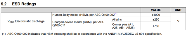

  • Hi Kyle
    I'm very sorry, but I'm confusing now...
    I pasted J6Entry again to the below.
    AM570x also has the footnote which is same with the one for AM335x.
    I mean, lock like that the test condition are different between DRA71x and AM570x, but ESP value for both are the same.

  • Tsurumoto-san,
    The test conditions and thus the reported ESD ratings for the DRA71x and AM570x are the same.
    The footnote has nothing to do with the test conditions - the footnote is saying ... "JEDEC standard says 500-V HMB is safe".  Considering we're 2x higher value on HBM (1000-V) that implies we have lots of margin to a safe test condition for HBM.  CDM of 250 meets the JEDEC safe recommendation.

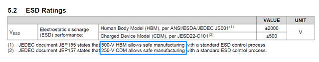

  • Hi Kyle
    OK, therefore, the test conditions for both DRA821 and AM335x are same.
    HBM => ANSI/ESDA/JEDEC JS-001(1)
    CDM => per JEDEC specification JESD22-C101
    So, I cannot understand well what does "the conditions that the different parts were tested in" mean which you commented at 1st your reply.
    Why ESD were different between DRA821 and AM335x?
    DRA821:
    AMM335x:
  • Tsurumoto-san,
    I meant that the test mechanism is the same as described by the ANSI/JEDEC standards.  The tables show the difference in the stress voltages applied.  Jacinto/Automotive has always used the 1000/250 V levels.  I don't know why Am335x tested higher.  I really don't think it matters considering 500/250 is deemed safe in the industry.
