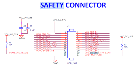

Please let me confirm about TMDS64GPEVM.
My customer is using Safety Connector and wants to use pin.11 and pin.13 of Safety Connector as UART and pin.9 as GPIO_input. However, when they downloaded PROCESSOR-SDK-AM64X and checked the device tree(k3-am642-evm.dtsi), it seems that status = "disabled". Also, the MCU_UART1 pin and MCU_GPIO0_7 pin setting is not defined.
Q1:They would like to change the CPU setting to the following, could you tell me how to change it?
Ball Number C9 -> MCU_UART1_RXD
Ball Number D9 -> MCU_UART1_TXD
Ball Number D7 -> MCU_GPIO0_7 (input)
Q2:If I refer to the following thread, can they add the pin settings for MCU_UART1 and remove the status = "disabled" to be able to use it?
URL:e2e.ti.com/.../change-pinmux-for-am335x-using-device-tree

  • Hi O.H,
    Technically it is possible to use MCU_UART1 in Linux by adding the pinmux settings and enabling the MCU_UART1 module node in devicetree. But there are more work needed in current Processor SDK to use MCU_UART1 in Linux, MCU domain padcfg is not unlocked in U-Boot, unlocking it is required for kernel to modify the pinmux settings. Also MCU domain pinmux controller is not defined in AM64x devicetree which is required for add MCU_UART1 pinmux settings in devicetree.

    Is there any other option than HSE connector to evaluate UART alone on TMDS64GPEVM?
    I have checked the schematic and could not find any pin for UART (other than MCU_UART) that can be directly connected to AM6442. The only way to do this is to use "Samtec SEAM-30-03.5-L-05-2-AK-TR" as shown in the following thread and extend it by myrself, is it correct?
    e2e.ti.com/.../tmds64gpevm-breakout-board-connector-for-j2--- hse-connector
    We don't mind using other pins as long as we can use the UART on the EVM. Any good advice would be appreciated.
    O.H
  • Hi O.H,
    Looking at the GPEVM schematics, MCU_UART1 is routed to the HSE connector, MCU_UART0, MAIN_UART0/1/3/ are on the FTDI USB connector. If you cannot use any of these, you probably can consider using either MCAN0/MAIN_UART4 on J9, or MCAN1/MAIN_UART5 on J10. Modify the pinmux to UART mode instead of MCAN.
