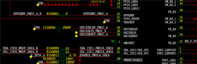

Is a 32.768k crystal necessary in PDN0B?
B&R
Lijia
In a multi-PMIC PDN, the 32kHz crystal is not needed on PMIC-B since PMIC-A has a 32kHz crystal.
yes, PMICB doesn't connect a crystal, I mean for PMICA(TPS65941212). there is a crystal but we didn't get any output wave form at Pin 38 and 39.
