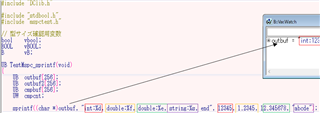

  • Hi Parth,
    Thank you for your reply. This is a question from a customer so I'm unable to test it.
    This is the code snippet that they have sent me.
    They are using sprintf and not UART_printf(). Should they not be using sprintf?

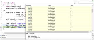

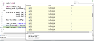

  • Hi Mari,
    sprintf will put the string into a buffer, to display that buffer on console I am using UART_printf(). Due to some reason their debugger is not displaying the value of outbuff properly. I tried the same thing on CCS and I am able to read the buffer properly.
    Can you please ask them to print the buffer and see if it is proper or to try it on CCS and read the value of outbuff?

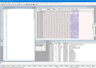

  • Hi Parth,
    Our customer has yet to try the binary file, but as an update they sent us an image which indicates that it is most likely not a debugger display issue. It appears that it is not writing to the outbuf variable. I've attached the image below for reference.
    What else do you think could be causing this issue?

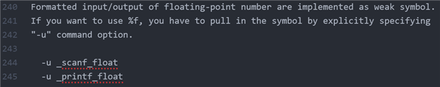

  • Hi Hideaki,
    Apologies for the delay here.
    In the readme document provided with the GCC compiler at <gccInstallPath>/share/doc/gcc-arm-none-eabi/readme.txt it is mentioned that "-u _printf_float" is needed for floating point numbers.
    I did not have to explicitly set this flag in my case, which I believe could be because of different compiler version. Could you ask customer to test and try with GCC GNU 7.3.1 and see if that works without explicitly setting the flag.

  • Hi Hideaki,
    They want to know this additional setting is correct solution or not.
    As mentioned in the compiler documentation "-u _printf_float" is needed to input the floating point values, so the additional setting done by them is the correct solution.
