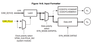

It is assumed that the camera data will be signal processed by an external device and input to the AM437x.
Looking at the TRM, it looks like his external PCLK input signal is only used to latch the CAM_D signal.
Is it okay to stop this PCLK if I don't use CAM_D ?

    Is it okay to stop PCLK if CAM_D is not transferring data? (If CAM_D is transferring data, of course PCLK will work.)
    If my understanding of how to use PCLK is wrong, please point it out.

    Thank you for clarifying. Yes, I believe your understanding is correct, PCLK only needs to be active while transferring data.
