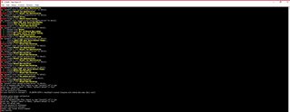

    However, the kernel does not boot successfully. Arago starts to boot, but stops in the emergency mode and asks for a password.
    I clicked enter as Arago afaik doesn't have a password but it says login incorrect. Any thoughts on this issue?
    Attached a screenshot as well if that helps.
  • Hi Jonas,
    The issue seems related to rootfs.
    Can we upload the full boot log as an attachment?
    -Hong

    [  OK  ] Listening on Journal Socket.
    [    7.652430] systemd[1]: Listening on Network Service Netlink Socket.
    [  OK  ] Listening on Network Service Netlink Socket.
    [    7.676714] systemd[1]: Listening on udev Control Socket.
    [  OK  ] Listening on udev Control Socket.
    [    7.699261] systemd[1]: Listening on udev Kernel Socket.
    [  OK  ] Listening on udev Kernel Socket.
    [    7.728813] systemd[1]: Mounting Huge Pages File System...
    [    7.752778] systemd[1]: Mounting POSIX Message Queue File System...
    [    7.784553] systemd[1]: Mounting Kernel Debug File System...
    [    7.822088] systemd[1]: Mounting Temporary Directory (/tmp)...
    [    7.839136] systemd[1]: Condition check resulted in Create list of static device nodes for the current kernel being skipped.
    [    7.863056] systemd[1]: Started Hardware RNG Entropy Gatherer Daemon.
    [  OK  ] Started Hardware RNG Entropy Gather[    7.873812] random: crng init done
    [    7.878985] random: 6 urandom warning(s) missed due to ratelimiting
    er Daemon.
    [    7.904577] systemd[1]: Starting RPC Bind...
    [    7.925617] systemd[1]: Condition check resulted in File System Check on Root Device being skipped.
    [    7.948797] systemd[1]: Starting Journal Service...
    [    8.047531] systemd[1]: Starting Load Kernel Modules...
    [    8.078050] systemd[1]: Starting Remount Root and Kernel File Systems...
    [    8.123508] systemd[1]: Starting udev Coldplug all Devices...
    [    8.231576] systemd[1]: Mounted Huge Pages File System.
    [  OK  ] Mounted Huge Pages File System.
    [    8.279869] systemd[1]: Mounted POSIX Message Queue File System.
    [  OK  ] Mounted POSIX Message Queue File System.
    [    8.319897] systemd[1]: Mounted Kernel Debug File System.
    [  OK  ] Mounted Kernel Debug File System.
    [    8.367593] systemd[1]: Started Journal Service.
    [  OK  ] Started Journal Service.
    [  OK  ] Started RPC Bind.
    [  OK  ] Mounted Temporary Directory (/tmp).
    [FAILED] Failed to start Load Kernel Modules.
    See 'systemctl status systemd-modules-load.service' for details.
    [  OK  ] Started Remount Root and Kernel File Systems.
             Mounting Kernel Configuration File System...
             Starting Flush Journal to Persistent Storage...
             Starting Apply Kernel Variables...
             Starting Create System Users...
    [    8.620746] systemd-journald[151]: Received client request to flush runtime journal.
    [  OK  ] Mounted Kernel Configuration File System.
    [  OK  ] Started Flush Journal to Persistent Storage.
    [  OK  ] Started Apply Kernel Variables.
    [FAILED] Failed to start Create System Users.
    See 'systemctl status systemd-sysusers.service' for details.
             Starting Create Static Device Nodes in /dev...
    [  OK  ] Started Create Static Device Nodes in /dev.
    [  OK  ] Reached target Local File Systems (Pre).
             Mounting /media/ram...
             Mounting /var/volatile...
             Starting udev Kernel Device Manager...
    [FAILED] Failed to mount /media/ram.
    See 'systemctl status media-ram.mount' for details.
    [DEPEND] Dependency failed for Local File Systems.
    [  OK  ] Mounted /var/volatile.
    [  OK  ] Stopped Dispatch Password …ts to Console Directory Watch.
    [  OK  ] Stopped Forward Password R…uests to Wall Directory Watch.
    [  OK  ] Reached target Timers.
    [  OK  ] Reached target Network (Pre).
    [  OK  ] Reached target Login Prompts.
             Starting Synchronize System and HW clocks...
             Starting Load/Save Random Seed...
    [  OK  ] Reached target Sockets.
    [  OK  ] Started Emergency Shell.
    [  OK  ] Reached target Emergency Mode.
             Starting Rebuild Dynamic Linker Cache...
             Starting Commit a transient machine-id on disk...
             Starting Create Volatile Files and Directories...
    [FAILED] Failed to start Synchronize System and HW clocks.
    See 'systemctl status sync-clocks.service' for details.
    [  OK  ] Started Load/Save Random Seed.
    [FAILED] Failed to start Commit a transient machine-id on disk.
    See 'systemctl status systemd-machine-id-commit.service' for details.
    [  OK  ] Started udev Kernel Device Manager.
             Starting Network Service...
    [  OK  ] Started udev Coldplug all Devices.
    [  OK  ] Started Create Volatile Files and Directories.
             Starting Run pending postinsts...
             Starting Rebuild Journal Catalog...
    [FAILED] Failed to start Network Time Synchronization.
    See 'systemctl status systemd-timesyncd.service' for details.
    [  OK  ] Reached target System Time Set.
    [  OK  ] Reached target System Time Synchronized.
             Starting Update UTMP about System Boot/Shutdown...
    [  OK  ] Started Network Service.
             Starting Wait for Network to be Configured...
    [FAILED] Failed to start Network Name Resolution.
    See 'systemctl status systemd-resolved.service' for details.
    [  OK  ] Reached target Network.
    [  OK  ] Reached target Host and Network Name Lookups.
    [  OK  ] Started NFS status monitor for NFSv2/3 locking..
    [  OK  ] Stopped Network Time Synchronization.
    [FAILED] Failed to start Rebuild Journal Catalog.
    See 'systemctl status systemd-journal-catalog-update.service' for details.
    [  OK  ] Stopped Network Name Resolution.
    [  OK  ] Started Update UTMP about System Boot/Shutdown.
             Starting Update UTMP about System Runlevel Changes...
    [  OK  ] Started Update UTMP about System Runlevel Changes.
    [FAILED] Failed to start Run pending postinsts.
    See 'systemctl status run-postinsts.service' for details.
    You are in emergency mode. After logging in, type "journalctl -xb" to view
    system logs, "systemctl reboot" to reboot, "systemctl default" or "exit"
    to boot into default mode.
    Give root password for maintenance
    (or press Control-D to continue):
  • Hi Jonas,
    Thanks for uploading the full log file.
    It seems kernel booting is ok, but something is abnormal when mounting rootfs...
    I'm passing it to my colleague for guidance.
    -Hong
