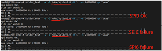

We are working on SDK8.0 with our customized board, we encountered a strange issue on SPI comunication.We made change on DTS with below configuration, and then test the SPI tx/rx loopback with spidev_test command. but got differrent result, SPI0 can received the Tx data, but SPI6 does not receive any data. Could you please help to figure out the rootcause?

below is the test result

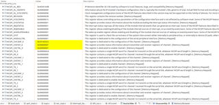

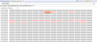

We also checked the register value, seems they are same configuration, check below iamge.
