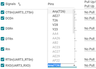

  • This is a custom board
    Also what is your final goal?  ---- We use uart3 to control Max96745
    Based on the above the pin muxing needs to be changed  -----  pinmux we have change to mode 14 (as same as TI pinmux tool)
    Could you show us a correct pinmux config for uart3?
    What I mean is that UART3_RXD & UART3_TXD come out on multiple balls for J721e:
    & for UART3_TAD

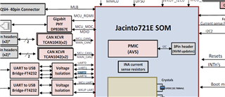

    Are you using a custom board to do this? As the J721e EVM does not have the UART3 brought out to the board.
    UART0/1/2/4 are brought out.
