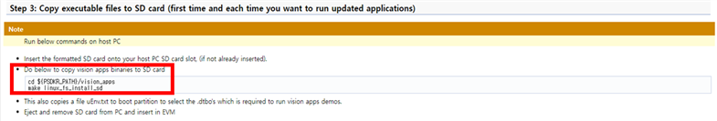

When I test board with sd card which is provided when purchase, I can access board with account 'root'.
But after set sd card using sdk-linux & sdk-rtos, it couldn't boot board anymore.
This is process that I refer to install sdk-rtos below.
software-dl.ti.com/.../RUN_INSTRUCTIONS.html
Here are my spec
board : J721EXCP01EVM(TDA4VM)
processor : J721EXSOMG01EVM(DRA829V)
SDK
LINUX : ti-processor-sdk-linux(ver. 08_00_00_08)
RTOS : ti-processor-sdk-rtos(ver. 08_00_00_12)
Test data : psdk_rtos_ti_data_set_08_00_00
Did I miss something with format SD card or make boot?

  • Hi Keerthy,
    I understood how it works when setting SD card boot as your advise.
    And I figured out why my device couldn't boot although following the manual.
    When I make linux_fs_install_sd, my uEnv.txt file is overwritten as below.
    psdk_setup_file=.psdk_setup
    check_psdk_setup=load mmc 1:1 ${loadaddr} ${psdk_setup_file}
    # Reset to the default environment
    do_psdk_setup=env default -f -a; saveenv
    # If not previously configured, then configure the environment and indicate this by writing a file
    uenvcmd=if run check_psdk_setup; then echo "Already setup."; else run do_psdk_setup; mw.b ${loadaddr} 0 1; fatwrite mmc 1:1 ${loadaddr} .psdk_setup 1; reset; fi
    dorprocboot=1
    name_overlays=k3-j721e-vision-apps.dtbo
    Kisik
