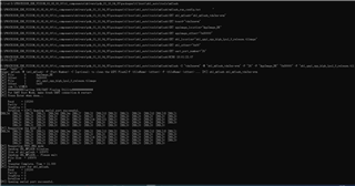

We use custom tda3x board via uart to download sbl and appimage to qspi.
Follow AppNote_mflash.pdf to config flash script and run script, it is failed.
1. my config script is  :
   SET sbl_mflash="sbl_mflash_tda3xx-evm"
   SET board="tda3xxevm"
   SET appimage_location="AppImage_BE"
   SET appimage_offset="0x80000"
   SET sbl_location="sbl_qspi_opp_high_ipu1_0_release.tiimage"
   SET sbl_offset="0x00"
   SET uart_port_number="26"
   ECHO %time%
   mflash -S %board% -M %sbl_mflash% -P %uart_port_number% -F %appimage_location% %appimage_offset% -F %sbl_location% %sbl_offset% -C

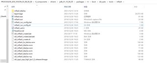

2. put sbl_qspi_opp_high_ipu1_0_release.tiimage and appimge under packages\ti\boot\sbl_auto\tools\mflash directory

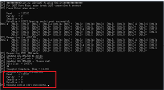

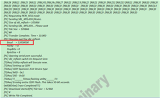

3. From appnote_flash.pdf section APPENDIX: baudrate is 12Mhz
   but my board baudrate is 115200:

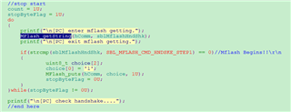

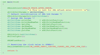

So My question is whether I need to re-compiler mflash_uart.c to generate mflash.exe?
I refer to the related topics on e2e,eg https://e2e.ti.com/support/processors-group/processors/f/processors-forum/949672/tda3xevm-mflash-incomplete?tisearch=e2e-sitesearch&keymatch=Building%252525252525252520mflash%252525252525252520for%252525252525252520TDA3xx#
