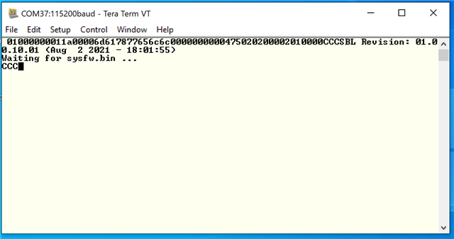

    I tried an AM6526 device on my socketed EVM, using X-modem protocol, and was able to see the transfer is complete. Details are:
    1. Install a AM6526BACDXA device to the socketed EVM, set EVM to boot via UART
    2. on MCU UART window, I can see the ...CCCC... char
    3. on Tera Term menus, go File->Transfer->Xmodem, selected sbl_uart_idk_8_0.bin, and saw the file was transferred complete, then UART window prompt for sysfw.bin. complete UART log (with garbage) are shown below. Note that I transferred SBL twice.
    Let me know if you want to try uniflash command lines. you will need to send me the full sequence and the uniflash version you used.

    01000000011a00006d617877656c6c0000000000475020200002010000CCCCCCCCCCCCCCCCCCCCCCCCCCCCCCCCCCCCCCCC01000000011a00006d617877656c6c0000000000475020200002010000CCCCCCCCCCCCCCC01000000011a00006d617877656c6c0000000000475020200002010000CCCCCCCCCCCCCCCCCCCCCCCCCCCCCCCCCCCCCCCC01000000011a00006d617877656c6c0000000000475020200002010000CCCCCCCCCCCCCCC01000000011a00006d617877656c6c0000000000475020200002010000CCCCCCCCCCCCCCCCCCCCCCCCCCCCCCCCCCCCCCCC01000000011a00006d617877656c6c0000000000475020200002010000CCCCCCCCCCCCCCC01000000011a00006d617877656c6c0000000000475020200002010000CCCCCCCCCCCCCCCCCCCCCCCCCCCCCCCCCCCCCCCC01000000011a00006d617877656c6c0000000000475020200002010000CSBL Revision: 01.00.10.01 (Aug 2 2021 - 18:01:55)
    Waiting for sysfw.bin ...
    CCCCCCCCCCCCCCCCCCCCCCCCC01000000011a00006d617877656c6c0000000000475020200002010000CCCCCCCCCCCCCCCCCCCCCCCCCCCCCCCCCCCCCCCC01000000011a00006d617877656c6c0000000000475020200002010000CCCCCCCCCCCCCCC01000000011a00006d617877656c6c0000000000475020200002010000CCCCCCCCCCCCCCCCCCCCCCCCCCCCC

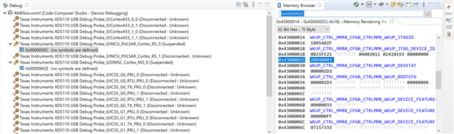

    I am able to transfer complete SBL that you shared by following the procedure Jian shared in one of the previous post.
    Also, I can confirm that the silicon revision is 2.1 by looking at Silicon Revision Register as mention in the thread  https://e2e.ti.com/support/processors-group/processors/f/processors-forum/1032107/faq-am6548-ctrlmmr_wkup_jtagid-register-value-for-sr2-1,

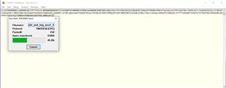

    When I try to boot via UART the following SBL:
    C:\ti\pdk_am65xx_07_03_00_54\packages\ti\boot\sbl\binary\am65xx_idk\uart\bin\sbl_uart_img_mcu1_0_release.tiimage   (size: 71092 bytes)
    Transfer got always stuck at packet #250 at the same amount of transferred data 32000 bytes:

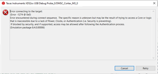

    Then I tried to connect via JTAG to the M3 core (using the CCS setup of our AM6548) and got the following error message:
    DMSC_Cortex_M3_0: Error connecting to the target: (Error -1274 @ 0x0) Error encountered during connect sequence.  The specific reason is unknown but may be the result of trying to access a Core or logic that is inaccessible due to a lack of Power, Clocks, or Authentication (i.e. Security is preventing).  If blocked by security, and if supported, access may be allowed after following the Authentication process. (Emulation package 8.3.0.00003)
    I guess that it is really a HS device (even if not marked on the label) and therefore M3 connection may be blocked.
    But I don't have any idea what causes the stop of xmodem boot.

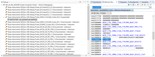

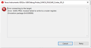

    Yes I confirm that I also cannot connect to R5. But I get a different error message:
      Ruediger
  • Hi Jian,
    I created a Target configuration file in which I excluded all GEL files that are used for initialization of A53 (M4_R5orA53_Startup.gel), R5 (M4_R5orA53_Startup.gel) and M3 (AM65xEVM.gel) cores
    Then I tried to connect to M3 and R5 cores and got the same error messages as Ruediger:

    Then I tried to connect to R5 core, and I can confirm that I can read  Silicon Revision Register:
    But still, i can not connect to the M3 core:

    But when I try to load them via TeraTerm to the target board the transfer got always stuck at packet #250 at the same amount of transferred data 32000 bytes (same problem like with SBL).
