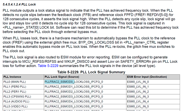

Dear TI Support,
I have read the TDA4 Technical Reference Manual, and I am concerned about the interrupt evernt of ESM. In Chapter '9.4 Interrupt Sources', there are some tables which introduce the interrupt map. But I could not find the interrupt description in the table. For example, you can see the table screenshot as follow. There are multiple interrupte name after 'PLLFRAC2_SSMOD', but it makes me confused to distinguish these events and set the priority.
So, I want to know the details about these interrtupt.
