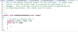

Issue:
1、The Timer3 interrupt goes into the system default interrupt after each 287 runs, and then running into a dead loop. The customer tries to increase the stack and finds that the larger the stack is set, the more times are entered into Timer3 interrupt. However, no matter how large the stack is set, the default interrupt is eventually entered as shown in the following figure. This should be a problem with the stack. Is there a way to debug?
2、As shown in the figure below, after each interrupt exit, it will quickly re-enter the interrupt.
In the interrupt service function, Test1 and Test2 are two IO ports on the board, and the screenshot shows the measured IO port for Test1.
The partial amplification of a single pulse is as follows:
Of these two adjacent pulses, "GICDRegs.ISACTIVE[2] = = 128" this event occurs in the first pulse. But this event does not occur in the second pulse. A spurious interrupt is mentioned in the GIC document of A15, is this a spurious interrupt?
In the interrupt function, the count value of the variable Count is 287, and Count1 starts adding 1 when GICDRegs.ISAKTIVE[2] = = = 128, so it counts 144, and then the interrupt enters the system default interrupt.
