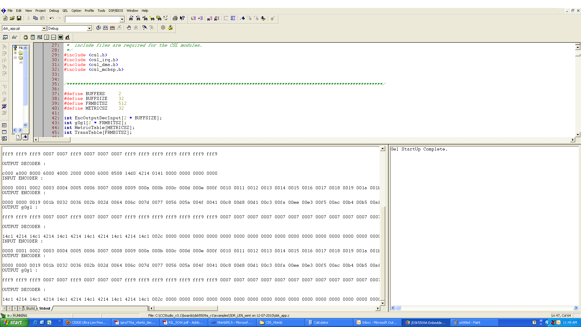

can you tell me what is the relation between the values for given terms below.
frame_word_sz = 12.
metric_sz = 32.
frame_bit_sz = 189.
How do we get those values and whats the relation between them
thanks habeeb
hi,
189 : information bits
12 : ceil(189/16)
32 : k 5

Kim thanks, but i still dont understand some part of it becoz the font doesnt show up i think.
i am going to put down what i understood, please tell me if i am right about it.
32 = 2 ^(k-1), where k = 5
12 = frame size in word = 189/16 = 11.81 = 12
how do we decide on the frame size to be 189
and am i correct on how we got the metric update number.
thanks Habeeb
hi,
16=2^(k-1), when k=5, 16x(old+new)=32
12= ok
you can pick any frame size. This example showed 189 which is one of modem protocol.
Hyun
Hyun,
I changed the numbers as such
frame_word_sz 32
frame_bit_sz 512
metric_sz 32
I am getting numbers which do not match the input given.
Do we have to follow certain protocol when giving the size for frame_bit_sz or is it becoz in the SPRA 776A the numbers of butterflies written have been defined for 189 bits only so on increasing the the frame_bit_sz we also need to write more butterflies.
Thanks, Habeeb
That example uses some hard coded and it's not flexible. You need to modify it to meet your requirements.
