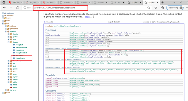

    Customer says " I did not know how to look up the heaps API. I was going on the release notes for the different revisions of the SYS/BIOS library. Yes, the version I am using does contain the Heap Tracker class as you have shown above. "
    Ok, I understand.
    Please let me know, the SYS/BIOS library version, you use. let me search for you on the heap track or the available API details.
    To know the sysbios version--> Go to project properties-->General-->products-->SYS/BIOS version
    Shankari G
  • Hello Shankari,
    I do not think you understood my last message so let try and explain it in more detail.
    I found the API reference in the cdoc folder and was thanking you for showing me that feature.
    The revision of the SYS/BIOS I am using is 6.34.4.22 and as I stated above it does support the Heap track class.
    I am simply looking for a way to attach the heap tracker to an existing heap stack.
    The example in the SYS/BIOS users guide has errors. I corrected some of them however I still have one remaining error and wish to resolve it so that I can test my code.
    Thank You,
    Forrest.

    This is what I did:-
    In the .cfg file
    var BIOS = xdc.useModule('ti.sysbios.BIOS');
    BIOS.heapSize = 0xF000;
    BIOS.heapTrackEnabled = true;
    In the .c file
    //shankari
    #include <xdc/runtime/Memory.h>
    #include <ti/sysbios/heaps/HeapTrack.h>
    //Global variables
    HeapTrack_Params prms;
    HeapTrack_Handle heap;
    Error_Block eb;
    Error_init(&eb);
    HeapTrack_Params_init(&prms);
    // The existing heap handle
    heapHandle = HeapBufMP_create(&heapBufParams);
    if (heapHandle == NULL) {
    System_printf("Error Core %d : HeapBufMP_create failed\n", coreNum);
    return;
    //shankari
    prms.heap = (xdc_runtime_IHeap_Handle)&heapHandle; // Attaching the existing handle to the Heap tracker here.
    heap = HeapTrack_create(&prms, &eb);
    if (heap == NULL) {
    System_abort("HeapTrack create failed");
    Output in debug window
    Alternatively, I have tested, HeapMemMP_getExtendedStats and the Memory_getStats functions too. And these functions are working too.
    Try these functions too, as these are comparitively easier than the heap tracker functions.
    Shankari G
