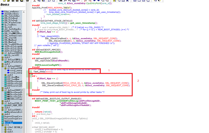

        I tried to use OSPI to decrease the startup time ,
        I used TI's demo("sbl_cust_img" and “can_boot_app_mcu_rtos”) and i tried to modified the demo(can_boot_app_mcu_rtos), so that it could jump to my APP and start the QNX.
        The startup process is:(sbl_cust_img -> can_boot_app_mcu_rtos -> start My APP & QNX)
       a. SBL_CUST_IMG: to start MCU1_0/MCU1_1
       b. CAN_BOOT_APP_MCU_RTOS: I modified it , I add " status = OSPIBootImageLate(&k3xx_evmEntry, OSPI_OFFSET_APP);", to read my App file;

 and then call the  SBL_SlaveCoreBoot(MCU1_CPU0_ID, 0, &k3xx_evmEntry, SBL_REQUEST_CORE); to jump to my APP.
It could jump to my APP correctly and start the QNX; But when i remove the "Task_sleep(4000)", it will lead QNX start failed, the error is :ti_sci_recv_message, unable to receive message

So my questions:
1. Why will it start QNX failed when i remove the "Task_sleep(4000)"? Is it because mcu jump to the other APP and it leads the sci server closed?
2. Is there has the other way to help us solve this problem? we want the bootloader could jump to my App and start QNX

    The A72 logs showing SCI failures are as you indicated, likely due to the sci server not running on the MCU1_0, at the time the A72 sends the SCI message to MCU1_0.  The A72 logs show the QNX BSP is attempting to enable the required clocks/states for GPU and OSPI, but not receiving expected response.
    The SCI Server must be running on the MCU R5 in order to for the A72 to send the SCI commands. Either A72 SCI commands must come later in boot sequence, or MCU R5 sciserver must be available earlier in boot sequence.
    An additional test would be to remove the Task_sleep(4000) from the MCU R5, and add the same delay on the A72 BSP prior to the SCI commands being sent, to ensure the boot works.
