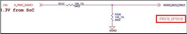

Hi team,
There is a circuit to convert 3.3V to 1.8V on J7AEPEVM. However, the power domain of GPIO10 is VIO(3.3V). Is this a wrong design in EVM? Thanks!
