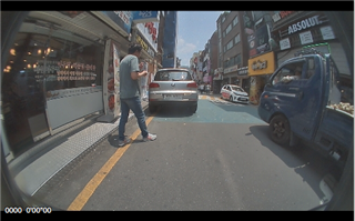

I have been trying to run app_tidl_od application with in_size and dl_size 512*320.
My input is a YUV NV12 512X320  image. I would expect the  BGR version of the same image as an output, however the output i'm getting is not as expected
Here are my node configuration parameters: mean_pixel = {0, 0, 0}, scale_val = {1, 1, 1}, pad_pixel = {1, 1, 0, 2}, tidl_8bit_16bit_flag = 1, ip_rgb_or_yuv = 1, color_conv_flag = 2, clear_count = 0, skip_flag = 0
The preproc output is having tensor sixes 513*323*3 and output is not as expected.
Did I miss anything?How to resolve this ?

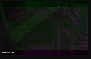

  • Hi Shyam,
    Thankyou for the response.
    Yes the expected output is  16 bit BGR out.I'm using vooya to visualise the output
    I have also shared the output file for your reference.
    pre_proc_output_0000000100_513x323_ch0.zip
    Sithara Tresa Chacko
  • Reposting with correct screen shot
    I used rawpixels.net and found that only half the image is written. Can you please tell me how this file was written?

  • Hi Sithara,
    I see that only half the image (in width) is written to file. We need to see what is happening inside the pre-proc function.
    Can you please help me get these values? you might have to recompile vision_apps to get the prints
    just do make vision_apps_scrub followed by make vision_apps -j8

  • The in_size and avail_size looks a bit wrong to me.
    expected in_size = ((512 * 8) + (512 * 4)) * 2 = 1228 (blk_width = 512, blk_height = 8, NV12 input, double-buffer so 2x)
    expected avail_size = 228 * 1024 (Available C66x L2 SRAM space)
    Which version of SDK are you using?

  • Please ignore the "TI Thinks Resolved" label for your reply.
    Hi Sithara,
    The 228 * 1024 was a typo and as you rightly indicated the avail_size should be not more than 224 * 1024.
    Now as for the logic, there were a few bugs we fixed post 7.1 SDK. I am attaching an updated file which has fixed a bugs.
    Please compare with the 7.1 version and take the latest portions.
