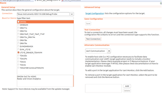

 I am trying to setup CCS debugging environment
XDS110 USB is plugged in and it is showing up in the set of removal devices in Ubuntu player list
Error Code:
