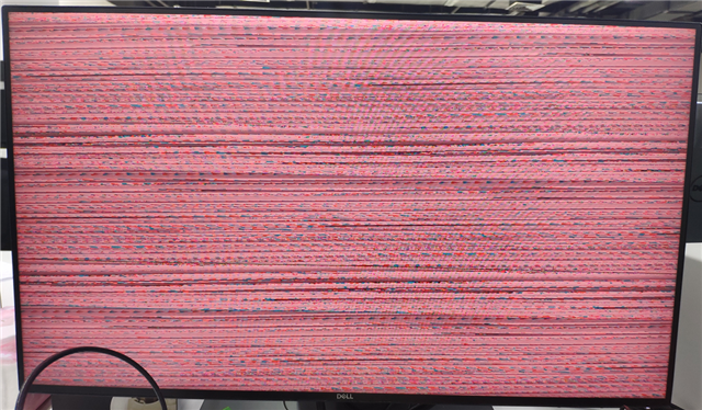

  • And when I run app_single_cam, the image shown in monitor is wrong, there is nothing but full of color stripes. Is there a problem with the app_single_cam configuration?
  • app_multi_cam does not have support for Live Tuning, needed for runtime interaction with DCC Tuning Tool. Please use app_single_cam.
    Can you please share the image you see with app_single_cam? If you can capture RAW and YUV image from tuning tool, please share those. Also list the steps you use - sensor, LDC selection etc.

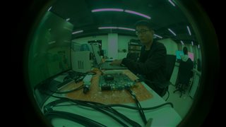

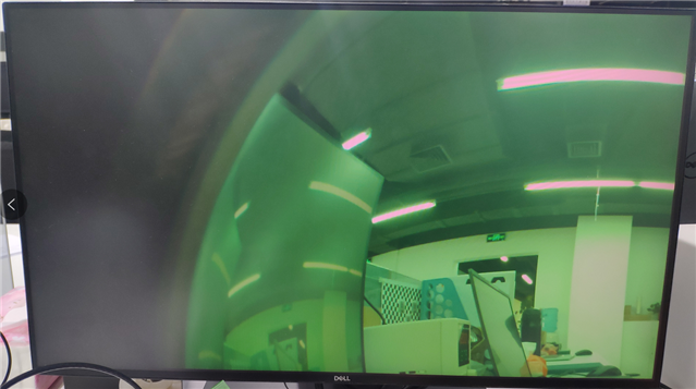

    The image of app_single_cam I saw on the monitor is shown below:
    while the image of app_multi_cam I saw on the monitor is shown below:
    but the YUV image saved from the board use app_multi_cam is bigger than the image on the monitor, the YUV/RAW images save from the board are uploaded below:
    YUV&RAW images.zip
    You can see  the steps I use (sensor, LDC selection) in the log files below:

  • VISS output from app_single_cam is correct. The issue is that MSC tries to downscale it to 1920x1080, but max downscale possible is 4x. 3848x2168 exceeds this ratio. It seems like app_multi_cam is displaying the image without downscale, therefore it looks correct but only top-left quarter of the image is displayed.
    Is it possible to configure the sensor as 3840x2160? If you can do this, app_single_cam will display correctly scaled full screen image.
  • Okay, I understand now, thanks.
    I will try to configure the sensor to 3840*2160 to see if it can be displayed normally on the screen.
    One more thing, can the problem of app_single_cam not displaying images normally be located because the sensor driver configuration is incorrect?
  • sensor driver configuration is not incorrect, but it is slightly higher than 4x of max display resolution (1920x1080).
  • Yes, I understand that the image from app_multi_cam is not fully displayed on the screen because of the ratio problem, but the image from app_single_cam is abnormal. I think this may be related to the sensor configuration.
    I think the ratio problem will only affect the display on the screen. The image saved on the board from app_single_cam should be normal. Isn't this problem caused by the sensor configuration? Or can you give some suggestions on the possible causes of this problem?
  • ISP output image saved from the board is correct. Please see attached
    Your sensor configuration is fine. The issue is with display.
  • Is the file you opened img_viss_0000_Ch00.yuv or img_viss 0000.yuv?
    The image files img_viss_0000_Ch00.yuv and img_ldc_0000_Ch00.yuv were saved by app_multi_cam, we can see normal images after opening img_viss_0000_Ch00.yuv, as shown in your reply.
    The other five files were saved by app_single_cam, the image we seen is abnormal after opening img_viss_0000.yuv (or img_0000.raw), as shown below:
    I think this may be related to the configuration of the sensor. What do you think about this problem?
  • I see the issue. Sensor configuration is the same through both the apps. The only difference is that app_single_cam checks if a 60fps mode is supported by the driver and enables it by default if the driver supports. You can disable that by removing the following code in app_single_cam_main.c
    if(ISS_SENSOR_FEATURE_CFG_UC1 == (sensor_features_supported & ISS_SENSOR_FEATURE_CFG_UC1))
    APP_PRINTF("CMS Usecase is supported \n");
    sensor_features_enabled |= ISS_SENSOR_FEATURE_CFG_UC1;
    After this change, sensor configuration is guaranteed to be the same between the two apps.
