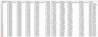

Does the quantization process occur during the conversion of the model by the tidlModelImport tool? The customer calls the PC_dsp_test_dl_algo.out tool on the converted int8 model to inference the picture, and then finds a coefficient difference between the parsed inference result and the inference result of onnx.
The quantization script is as follows:
modelType          = 2
numParamBits = 8
numFeatureBits = 8
inputNetFile = "../../test/testvecs/collate/fs_noCoord/models/fs_noCoord.onnx"
outputNetFile = "../../test/testvecs/collate/fs_noCoord/infer/8/tidl_net_fs_noCoord.bin"
outputParamsFile = "../../test/testvecs/collate/fs_noCoord/infer/8/tidl_io_fs_noCoord_"
inDataNorm = 1
inMean = 123.675 116.28 103.53
inScale = 0.017125 0.017507 0.017429
resizeWidth = 480
resizeHeight = 480
inWidth = 480
inHeight = 480
inNumChannels = 3
inData = ../../test/testvecs/collate/fs_noCoord/calib_list.txt
postProcType = 0
The inference results for the int8 model are as follows:
-33.00000000
-41.00000000
-42.00000000
-40.00000000
-41.00000000
-32.00000000
-27.00000000
-22.00000000
-25.00000000
-37.00000000
The inference for onnx is as follows:
-14.12847805
-17.56087685
-18.81339073
-17.77967834
-18.89683342
-14.82417774
-13.74363136
-11.10289955
-12.24503803
-17.49886703
The customer would like to know how to get the desired coefficients for the final model output to be converted to the output of the float model. Thanks!
