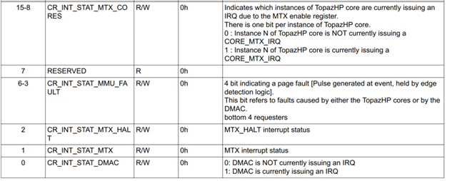

[MCU2_0]   5599.276205 s: TIMEOUT: topazdd_wait_on_sync timed out waiting for writeback 0x05a80000.
     I try to analyze the source code(SDK 7.00),The function osa_irqreturn_t topazdd_isr(void * inst_data) was found to have entered the branch of “ Page fault ”,Then all interrupts were disabled.
     Reg  TOPAZHP_TOP_CR_MULTICORE_INT_STAT  is 0x80000011
     Reg  TOPAZHP_TOP_CR_MMU_STATUS                 is 0x00000001
     So please help me to locate why this problem occurs?

    Please ignore the below error. It is harmless.
    Did you change anything in the memory map? or are you using default released memory map?
    The codec requires additional memory on the core on which it is running, so can you please keep the memory map same on this core?

  • HI Brijesh,
         Thanks for your reply. The part I changed in gen_linker_mem_map.py has been marked in the above picture.

    Then I  run the  gen_linker_mem_map.py. The released memory map has been changed.
          And question is that how can I keep the memory map same on this core?
          I didn't find a place to configure the codec memory map,  please help me find it ?
     Best regards!
    Could you search in the memory map? There is a local heap on mcu2_1 (or non-cached scratch memory), which is set to higher size for codec?
    Also if you revert these changes, does the codec work fine? Just want to see if the issue is due to memory map changes?

  • HI Brijesh,
         In addition to changing gen_linker_mem_map.py, we also changed k3-j721e-som-p0.dtsi. I will recover these two files then try codec again.

  • Hi Zhang huicheng,
    I guess you are using old release, SDK7.0.. Because in newer release, codec runs on mcu2_1.
    Yes, on the SDK7.0 release, please search for scratch, non-cached, heap memory for mcu2_0 in your memory map. You could look for these sections in ti-processor-sdk-rtos-j721e-evm-07_03_00_07/vision_apps/apps/basic_demos/app_tirtos/tirtos_linux/system_memory_map.html file..
    Brijesh
  • HI Brijesh,
         I forgot to modify r5_mpu.xs. The problem is solved.
         Thanks a lot!
