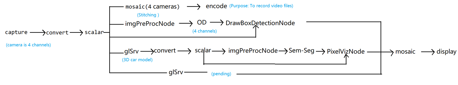

    I want to use two tivxVpacMscScaleNode, but the result is no graphics.It's show:
[MCU2_0] 40.839950 s: src/fvid2_drvMgr.c @ Line 759:
[MCU2_0] 40.839994 s: Driver create failed!!
[MCU2_0] 40.840030 s: VX_ZONE_ERROR:[tivxKernelImgMosaicMscDrvCreate:749] Fvid2_create failed
My code:
graph_parameter_index = 0;
add_graph_parameter_by_node_index(obj->graph, obj->captureObj.node, 1);
obj->captureObj.graph_parameter_index = graph_parameter_index;
graph_parameters_queue_params_list[graph_parameter_index].graph_parameter_index = graph_parameter_index;
graph_parameters_queue_params_list[graph_parameter_index].refs_list_size = MAX_NUM_BUF;
graph_parameters_queue_params_list[graph_parameter_index].refs_list = (vx_reference*)&obj->captureObj.capt_frames[0];
graph_parameter_index++;
vxSetGraphScheduleConfig(obj->graph, VX_GRAPH_SCHEDULE_MODE_QUEUE_AUTO, graph_parameter_index, graph_parameters_queue_params_list);
tivxSetGraphPipelineDepth(obj->graph, APP_PIPELINE_DEPTH);
tivxSetNodeParameterNumBufByIndex(obj->convertObj_1.node, 1, 6);
tivxSetNodeParameterNumBufByIndex(obj->scalerObj_1.node, 1, 6);
tivxSetNodeParameterNumBufByIndex(obj->scalerObj_1.node, 2, 6);
tivxSetNodeParameterNumBufByIndex(obj->scalerObj_2.node, 1, 8);
tivxSetNodeParameterNumBufByIndex(obj->scalerObj_2.node, 2, 8);
tivxSetNodeParameterNumBufByIndex(obj->imgMosaicObj_tmp.node, 1, 6);
Will scalar nodes not be nested?
PS :
capture -> convert -> scalar 1->scalar2->mosaic->display

    If mosaic node is removed, it works fine.
    The graph is :
    capture -> convert -> scalar 1->scalar2->display
    What is the cause of Mosaic's error(Fvid2_create failed) please?  Is my graph parameter set wrong, or should I not use it this way?
  • Hi ye ma,
    I suspect the scalar is running out of the instances.. Most likely, it is nothing to do with the mosaic node as such, even if you keep scalar1 -> mosaic, it would work.
    Internally all scalar node uses MSC from VPAC and this driver supports limited number of instances..
    You would probably have to increase the number of instance to run this graph.
    Can you try increasing VHWA_M2M_MSC_MAX_HANDLES macro value in ti-processor-sdk-rtos-j721e-evm-08_00_00_12\pdk_jacinto_08_00_00_37\packages\ti\drv\vhwa\include\vhwa_m2mMsc.h and then rebuilding SDK?
    Brijesh
  • Hi  Brijesh Jadav
        Thank you very much.  You perfect solution to my problem.
        However, I would like to ask a question, you said that the VPAC driver supports a limited number of instances. So, what is the mapping between the M2M_MSC instance and the node?  I see that the original value here is 8, and I have only created [ 2 Scalar + 1 Mosaic ], why is it exceeding the number of instances?
  • Hi ye ma,
    Yeah, that's surprising. It should not fail in this case. Scalar internally uses just single driver instance and so mosaic node. So there are only 3 instances opened.
    Could you please put some debug code in ti-processor-sdk-rtos-j721e-evm-08_00_00_12\pdk_jacinto_08_00_00_37\packages\ti\drv\fvid2\src\fvid2_drvMgr.c in Fvid2_create and also in Vhwa_mscAllocHdlObj API in the file ti-processor-sdk-rtos-j721e-evm-08_00_00_12\pdk_jacinto_08_00_00_37\packages\ti\drv\vhwa\src\drv\vhwa_m2mMscApi.c to see where exactly it fails?

        This is a very complex instance. As below:
        Can you give me some guidance on why the two Mosaic failed?  Thank you very much.
  • Hi Ye Ma,
    Scalar driver by default supports at max 8 handles.. since you are using above path for 4 channels, the two scalar node itself will consume 8 handles, and then when mosaic node tries to open scalar driver, it will fail.
    Could you please try increasing number of handles in the scalar driver as i suggested before? Also can you please spread scalar on two instances? Scalar and mosaic are supported on two scalar targets.. Can you keep scalar1 on MSC1 and scalar2 on MSC2 and similarly for mosaic node? This will spread the load on MSC, otherwise you might see performance issues (depending on resolution and fps) on scalar..
    Brijesh
