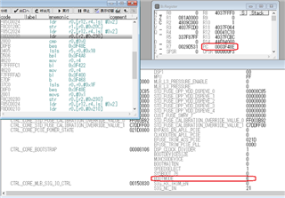

Hi team,
I received the inquiry about SD bootup. Our customer is developing their system with AM5716. Although customer created some prototype boards, on one of them, customer encountered the issue that AM5716 cannot boot from SD card.
As BOOT_MODE, customer is configuring sysboot [5: 0] = 6b’000_110 (1st:SD 2nd:QSPI_1). Customer tried to boo from SD card under this condition, however, it seems it will stop halfway..
Customer tried to check the internal registers when this issue occurred, BOOT_MODE seems to be recognized correctly but, it seems that their system stopped on ROM code as follows.
And then, customer checked the CMD like of SD card, when AM5715 received data after sending the following command, their system seems to stop.
          [ Command ] A8_80_00_3E_8E_8F_FC_44_00_0024_01_9F_FF (after that, all data shows FF, it means, it shows high signal.)
Can I have your advice/comments on this  issue, please?
