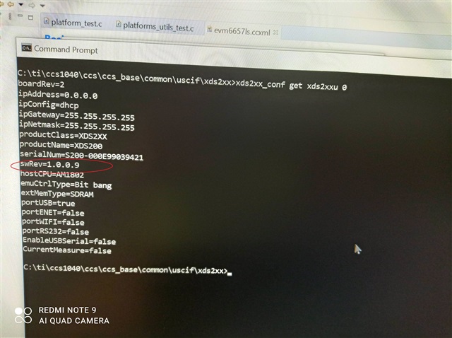

    When I try to connect using Debug I get this output
    IcePick_D_0: Warning: A firmware update is recommended for the XDS200 debug probe. Click the "Update" button to update the firmware. Click the "Continue" button to continue without updating. (Emulation package 9.4.0.00129)
    C66xx_0: GEL: Error loading file 'F:\ti\ccs1040\ccs\ccs_base\emulation\boards\evmk2e\gel\evmk2e.gel': line 2813: unexpected token: 1000
    This computer is on a network that doesn’t allow access to most ‘outside’ sites.  When I tried to do the update for the XDS200 it just timed out.
    Note that I am able to connect to the Arm core as shown below:
    I’m curious, the original problem lies in the program_evm module indicating an illegal processor ID.  Are these somehow related?  I haven’t used CCS for quite some time so I’m just trying to understand what we’re testing here.
    Any pointers to CCS documentation is welcome!

  • Dear Customer,
    Customer says" When I try to connect using Debug I get this output
    IcePick_D_0: Warning: A firmware update is recommended for the XDS200 debug probe. Click the "Update" button to update the firmware. Click the "Continue" button to continue without updating. (Emulation package 9.4.0.00129) "
    You have to update the firmware on the onboard emulator-xds200.
    To update the firmware of the onboard emulator, please follow these steps. The same steps, I have captured and documented as FAQ.
    https://e2e.ti.com/support/processors-group/processors/f/processors-forum/1048033/faq-processor-sdk-c665x-how-to-update-the-firmware-of-the-inbuilt-xds-emulator-on-c6657-evm-the-xds-in-the-evm-has-the-older-firmware-which-does-not-connect-work-with-ccs-9-3?tisearch=e2e-quicksearch&keymatch=FAQ%20firmware%20update
    Steps to update the firmware:
    Go to the directory where the utility is installed:
    C:>cd C:\ti\ccs0930\ccs\ccs_base\common\uscif\xds2xx
        b. Launch and Run the configuration file (.cxml )  just to make sure a XDS200-class debugger is connected.. and to know the firmware-revision installed on it.
    C:\ti\ccs0930\ccs\ccs_base\common\uscif\xds2xx>xds2xx_conf get xds2xxu 0
        c. Run the commands in the exact order shown below:
    C:\ti\ccs0930\ccs\ccs_base\common\uscif\xds2xx>xds2xx_conf update xds2xxu 0 xds200_firmware_v1009.bin
    C:\ti\ccs0930\ccs\ccs_base\common\uscif\xds2xx>xds2xx_conf program xds2xxu 0 xds2xx_cpld_v1009.xsvf
    C:\ti\ccs0930\ccs\ccs_base\common\uscif\xds2xx>xds2xx_conf boot xds2xxu 0
      d. Run the command in step 2 again to check that the correct firmware was loaded.
