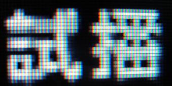

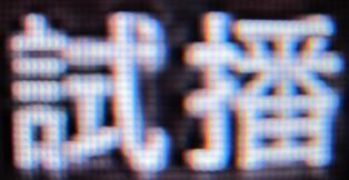

We found the 1080i encoding video quality issue, see the OK and NG picture as below:
OK:
NG:
It seems ODD and EVEN lines are inversed, we have checked and fine tuned the vpfe and vpbe drivers' parameters and then didn't work.
