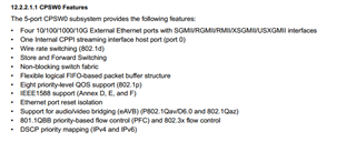

I am planning to use the cpsw of main domain to use the cpsw0 9 ports switch.I found that there isn't any device tree file which enable the cpsw of main domain.Is there any guiding file for me to edit a device tree file for enable cpsw switch and mac?
and in the  <J721E DRA829/TDA4VM Processors Silicon Revision 1.1 Texas Instruments Families of Products>, it says that the cpsw0 is 5 ports switch(Page )
but later it says it is 9-port switch. what does it mean?
    TDA4VM has a CPSW9G switch. I was not able to find the reference you mentioned. Can you post the link to the document you are mentioning so that I can look into it.
    The CPSW9G has a virtual net driver support on linux and hence there is no applicable device tree. The CPSW9G is controlled by ethfw.
