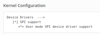

    - and in order to use the spidev driver under /dev directory, kernel configuration shown in fig.3 is selected.
          Fig. 3. Kernel configuration for spidev

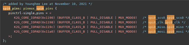

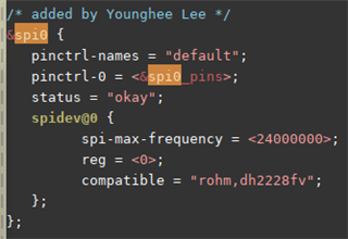

    - Since SPI0 is used to connect our peripheral, the followings are added to keystone-k2g-evm.dts file.
    - And then build zImage -> compile the device tree binary such as keystone-k2g-evm.dtb -> compile kernel modules -> copy zImage, dtb, and kernel modules to SD card.
    - When k2gevm is booted with this new kernel, /dev/spidev* file is not created.
