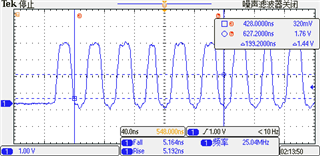

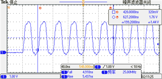

    This code can get periodically pull up and down on the R30 bit16:
    And in my case, I found that the SBBO cost 4 PRU clock cycles. So I'm wondering that if the SBBO cost cycles is adding by how many bytes are stored to memory?

    I can not get a periodically pull up and down on the R30 bit16. Is there any instruction optimization when the SBBO and ADD are near by each other?
