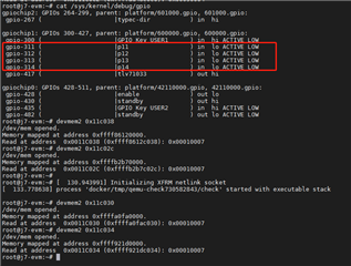

I configure the dts as below screenshot1 shown, then re-build the linux kernel and replace the old .dtb files with the new ones, but I found the /sys/kernel/debug/gpio information does not match configuration in dts,it should be output-high expectantly. Besides,the line-name of /sys/kernel/debug/gpio is also not correct,please help to check, thanks in advance.
k3-j721e-common-proc-board.dts:
/sys/kernel/debug/gpio:
Best Regards
    What is the physical status of those lines? Are they actually high? Have you measured the same via oscilloscope?
    Check the pin mux of all the pins.
    Keerthy
    yes, I have measured them via oscilloscope, and they keep in low and no output.

  • Hi Keerthy,
    These are the register values of the GPIOs:

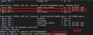

    All of the register values are 0x00010007, meaning PIN_GPIO_INPUT I think. And in other to verifiy your assumtion  "It must be issue with the pinmux settings",  I have tried to remove all the other cores firmware in /lib/firmware, just to run A72 only, but all the gpios' register values are still 0x00010007, nothing change.
  • Hi Veitch,
    Can you try this from Linux command prompt:
    devmem2 0x11C02C w 0x08050007
    Bit18 has to be set:
    Similarly for the other pin mux registers & let me know if you can see the GPIO lines toggling physically.

  • Hi Keerthy,
    It will work with operating the register directly, but I need to make it work with dts configuration, that's the point I think.
  • Veitch,
    Refer: "arch/arm64/boot/dts/ti/k3-j721e-common-proc-board.dts"
    sw10_button_pins_default: sw10-button-pins-default {
    pinctrl-single,pins = <
    J721E_IOPAD(0x0, PIN_INPUT, 7) /* (AC18) EXTINTn.GPIO0_0 */
    So your pins that need to be controlled as GPIOs need to be defined as above for pin mux. Follow the above settings for the pins
    that you want as GPIOs. Then the hardware will toggle as expected.

    Please make all of them PIN_INPUT. That should solve your problem unless some thing else over rides.
    At PAD level you need to keep it PIN_INPUT & at GPIO level you can make it output and write whatever values you want it to take.
    - Keerthy
  • Hi Keerthy,
    with your help, the register value is correct now, but why dose the GPIO level setting take no effect?  I have already configured it to output-high, and there is also no output-high state measured via oscilloscope. thanks
    + p14: p14 {
    + gpio-hog;
    + gpios = <14 GPIO_ACTIVE_LOW>;
    + output-high;
    + lines-name = "AG24";
  • + gpios = <14 GPIO_ACTIVE_LOW>;
    You are telling ACTIVE_LOW. Can you try:
    gpios = <14 GPIO_ACTIVE_HIGH>;
    output-high;
    If that helps then please click on verify answer.
    Keerthy
