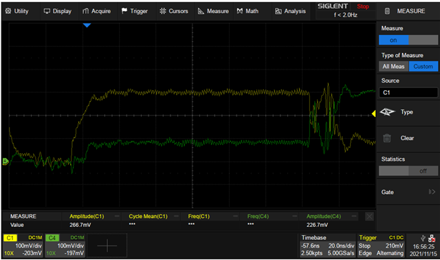

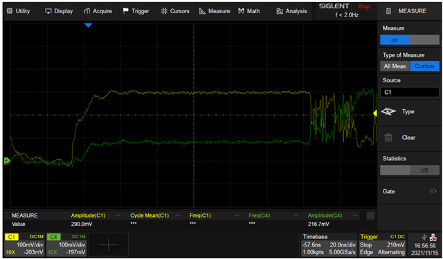

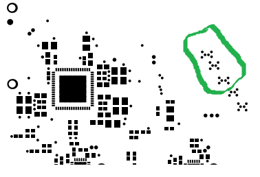

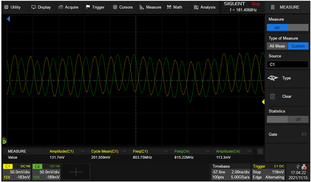

  • Can you confirm that TDA4 is getting CSI clock and data signals? Please share a waveform.
  • Hi Mayank,
    Measurements have been carried out at these points of the fusion board:
    Clock Signal:
    CSI Data Lane 1:
    CSI Data Lane 2:
    Mohamed
