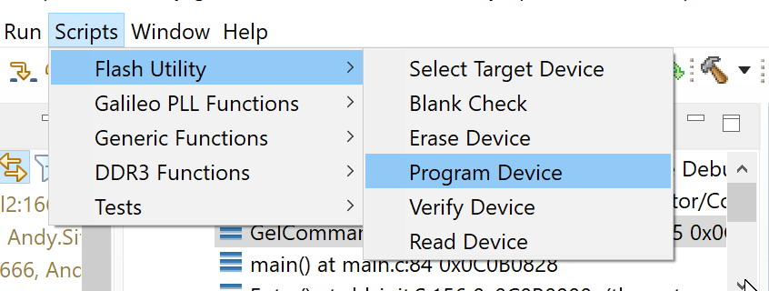

Summary of how this is supposed to work: When a user selects from the CCS Scripts menu either of the options Call_MyFunc1 or Call_MyFunc2, the GelCommand() function is supposed to populate two global variables in the target, then run the firmware. The firmware is supposed to call the selected firmware function (MyFunc1() or MyFunc2()), and then after returning from the function, halt again at the software breakpoint. The GEL script is then able to retrieve the return value from the function.
But the GEL script hangs on the line of code that waits for the firmware to be halted. Meanwhile, the firmware is in fact halted at the software breakpoint.
Please tell me how to accomplish what I am trying to do here.

  • One is the issue of GEL being (mostly) asynchronous in behavior.
    As I experiment more with this, my common above seems to be the biggest factor. GEL is not ideal for automation beyond simple target initialization. Anything beyond that we recommend DSS. Unless there is some specific reason that GEL is needed, I would try the above steps with a DSS script.

  • Sounds good. DSS will absolutely be the better option here. GEL has many limitations thatDSS resolves with regards to automation beyond a few simple tasks.

  • Hi Ki,
    Thank you, I got openSession() to work by providing the correct parameter:
        debugSession = debugServer.openSession("Blackhawk XDS560v2-USB System Trace Emulator/CortexA15");
    Is your end goal to run your script all from the command line or from within an active debug session like you would do with GEL?
    I am creating a flash programmer utility. Firmware will provide functions to program NOR SPI flash devices on our custom board with bootable images, including a secondary bootloader and the application firmware for both cores. I have imagined that a submenu under the Scripts menu would provide the user interface, though I am open to suggestions for other approaches.
    I am still figuring out how to make this work.
    GEL scripts are able to open dialog and slider pop-up windows to allow the user to provide input parameters. I don't see any similar facilities in DSS. So my "Select Target Device" option in the above screenshot will need a way for the user to specify which flash device on the board to program. What do you recommend for this?
    Likewise, I would like to be able to show an animated "progress bar" that updates as each of these operations proceeds (i.e. blank check, erase device, program device, verify device). It's not obvious how to get the JavaScript/DSS tools to do this. Can you suggest a way to do this?
    Thank you.
    Andy
  • GEL scripts are able to open dialog and slider pop-up windows to allow the user to provide input parameters. I don't see any similar facilities in DSS. So my "Select Target Device" option in the above screenshot will need a way for the user to specify which flash device on the board to program. What do you recommend for this?
    Ahhh... yes, you are correct. Those nice little GEL GUI items are not supported.via DSS. Hmmm... in that case, it may be necessary to run the custom command from the Scripting Console so that you can call the function with parameters.
    DSS is designed for command-line automation and lacks most GUI items like sliders, progress bars, etc. Any kind of "progress" feedback is usually done the old fashioned way by printing text to a console.
    Going back to the original issue, does using DSS resolve the previous asychronous issues that was occuring with GEL?
    Also note that if you are going to use the scripts only from inside a CCS debug session, then you can shorten your script by using the existing 'activeDS' object to refer to the current debug session in context. That way you can skip the steps of specifying a target config, creating a scripting instance, opening a debug session, etc.
    https://software-dl.ti.com/ccs/esd/documents/ccs_scripting_console_view.html#services
    Again, activeDS is only useful when running scripts inside an active CCS debug session (it is created when a debug session is launched)
