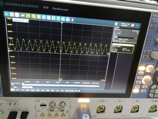

I has a board hang on uboot, the uart print "Timeout during frequency hands".
The SDK version is 7.3.
The DDR clk we measured with the oscilloscope seems to be normal.
Could give me some suggestion about this issue?

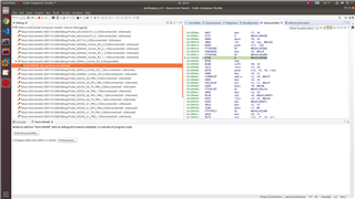

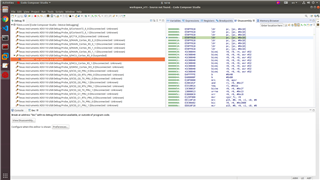

  • Hi Nathan,
    I have sent my colleague a binary file to run on the R5 (loaded through CCS / JTAG) that will capture additional helpful information. Can you please collect this data by using this binary when the issue occurs, and send the data back to my colleague? Can you also please provide the filled in XLS sheet?
    Kevin
  • Hi, Kevin,
    Thanks for your reply!
    I tried to load this binary, but I don't see any output.What is the data you are talking about?
    The xls file is Jacinto7_DDRSS_RegConfigTool_micron3733.xlsm and we change the values of DDRSS PHY 33,289,801 from 0x0C002007 to 0x0C002006.
    Best Regards
    Nathan
