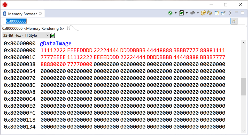

5. With the Memory Browser window open to address 0x80000000, I can confirm that the buffer is still filled with zeros.
6. If I now step OVER function Board_DDR3Init(), the Memory browser shows that the first 64 bytes of DDR3 (the start of my large buffer) has been overwritten with the following pattern.
Further experimentation has shown that the same behavior occurs within the GEL script, too.
I would like to understand the source of this phenomenon, so I can have assurance that my data will not be overwritten at an inconvenient time.

    As I've thought about this behavior, it has occurred to me that function Board_DDR3Init() does its job by writing to the EMIF registers, which will possibly cause a momentary reconfiguring, or reset, of the DDR3 refresh timing. I don't know how long this takes (i.e. whether it is longer or shorter than a refresh interval), so I don't know whether other DDR3 memory is affected. But perhaps it is during this process of changing DDR3 timing that part of DDR3 memory is overwritten.
    So perhaps the question really is, Can we count on any DDR3 memory containing valid data after calling Board_DDR3Init() ?

    I experimented this on my K2G EVM and didn't see this behavior. DDR memory was not changed by Board_DDR3Init(). Since you are using a custom board, there may be a need to modify and rebuild the board lib.
    The GEL script you mentioned should be running when you connect the ARM core in CCS. Did you mean the DDR memory was filled with those patterns when the ARM core was connected? Or did you manually run any GEL script after connection?

    After the evmk2g_arm.gel script completes execution, the program is loaded into target memory. When the load is complete, the debugger is halted with the PC at main(). The patterns are seen in memory at this time.

    I still don't see any reason why DDR would be filled by Board_DDR3Init() with those specific patterns you mentioned earlier.
