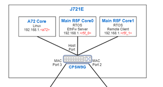

As the Ethfw User guide said, i can place remote client to MCU2_1 and enable A72 Core's virtual eth dirver.
I found that i can't ping Remote Client(MCU2_1) in A72 Core. But when i try to ping A72 Core and MCU2_1 through MAC Port 3, i can access both of them.
Could you help me to explain the situation? How to solve it ?
Hutian
    Because that would mean that you are trying to ping internally through the SoC, it's not supported right now. It would require A72, R5F to act as independent MAC entities.
    Yes, as explained above, an external entity would be able to reach these MAC addresses.
