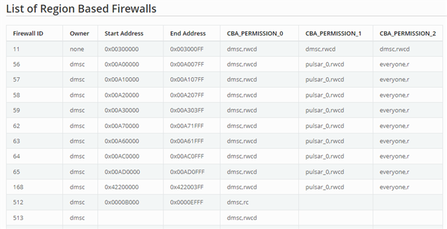

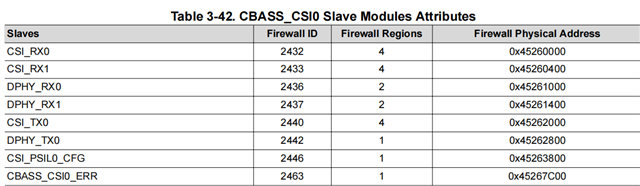

The Firewalls in TRM(version 1.1) table 3-40 ~ table 3-54 are mostly not defined in the table of “List of Region Based Firewalls” in software-dl.ti.com/.../firewalls.html, such like
the above Firewalls are not in
So my question is :
  • Can Firewalls in TRM be set (configure, enable, etc.) via TI SCI interfaces?
  • If these TRM Firewalls are already defined in SYS FW, what’s the default definition (e.g. owner, address, permissions, host id) of them?
    Please reference the below header file for supported definitions:
    pdk_jacinto_xx_yy_zz_aa/packages/ti/csl/soc/j721e/src/csl_soc_firewalls.h
    The TISCI interface should be used for programming firewalls and the above header file definitions should be supported.
    Regarding default settings for the firewall will need to follow up.
