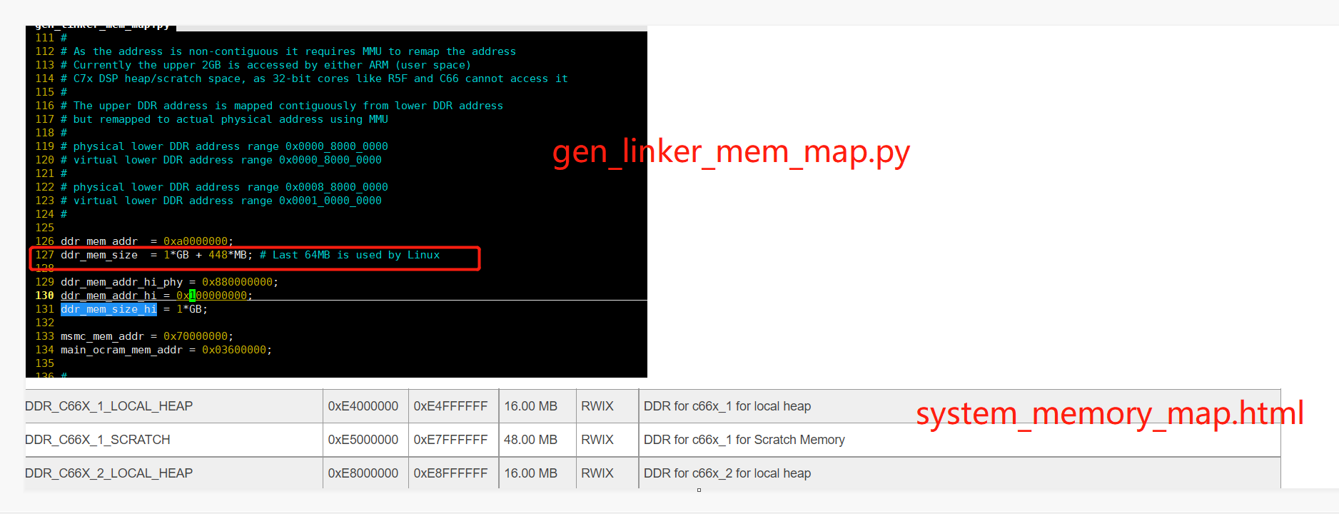

         We used 4GB of DDR memory before, and the linux system run normal, recently we changed the DDR 4GB to 1.5GB, and correspondingly modified the DDR memory node in uboot and kernel as follow:
update bootargs to  console=ttyS2,115200n8 earlycon=ns16550a,mmio32,0x02800000  root=PARTUUID=3946f6eb-02 rootfs=ext4 rw rootwait loglevel=8 cma=32M mem=1536M.
      The error is printed as follows
   Compared with the DDR configuration of 4G, there are the following problems
  Question 1: 0xFC000000~0xFFFFFFFF. why Last 64MB is used by Linux
  Question 1: 0x80000000~0x9FFFFFFF. Is the above address reserved for Linux?
   The relevant files of 4G DDR configuration are shown in the figure below:
  •   Question 1: 0x80000000~0x9FFFFFFF. Is the above address reserved for Linux?
    Yes typically this will be used by Linux. Basically whatever is marked as reserved-memory in DT will not be touched by Linux but the rest will be used by Linux.

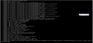

  • U-Boot SPL 2020.01-g (Nov 29 2021 - 15:50:28 +0800)
    SYSFW ABI: 3.1 (firmware rev 0x0015 '21.1.1--v2021.01a (Terrific Lla')
    Reading on-board EEPROM at 0x50 failed 1
    Trying to boot from MMC2
    Starting ATF on ARM64 core...
    NOTICE: BL31: v2.4(release):2021.00.001-dirty
    NOTICE: BL31: Built : 18:29:40, Sep 30 2021
    U-Boot SPL 2020.01-g (Nov 29 2021 - 16:20:58 +0800)
    i2c_write: error waiting for data ACK (status=0x116)
    Error reading output register
    U-Boot 2020.01-g (Nov 29 2021 - 16:20:58 +0800)
    SoC: J721E SR2.0
    Model: Texas Instruments K3 J721E SoC
    Board: J721EX-PM1-SOM rev E2
    DRAM: 1 GiB
    not found for dev hbmc-mux
    Flash: 0 Bytes
    MMC: sdhci@4f80000: 0, sdhci@4fb0000: 1
    In: serial@2800000
    Out: serial@2800000
    Err: serial@2800000
    Net: Could not get PHY for ethernet@46000000: addr 0
    phy_connect() failed
    No ethernet found.
    Hit any key to stop autoboot: 0
    switch to partitions #0, OK
    mmc1 is current device
    SD/MMC found on device 1
    817 bytes read in 4 ms (199.2 KiB/s)
    Loaded env from uEnv.txt
    Importing environment from mmc1 ...
    Running uenvcmd ...
    12230664 bytes read in 511 ms (22.8 MiB/s)
    108100 bytes read in 9 ms (11.5 MiB/s)
    ## Flattened Device Tree blob at 88000000
    Booting using the fdt blob at 0x88000000
    Loading Device Tree to 000000008fee2000, end 000000008fffffff ... OK
    Starting kernel ...
    [ 0.000000] Booting Linux on physical CPU 0x0000000000 [0x411fd080]
    [ 0.000000] Linux version 5.4.106+ (oe-user@oe-host) (gcc version 9.2.1 20191025 (GNU Toolchain for the A-profile Architecture 9.2-2019.12 (arm-9.10))) #1 SMP PREEMPT Mon Nov 29 15:53:04 CST 2021
    [ 0.000000] Machine model: Texas Instruments K3 J721E SoC
    [ 0.000000] earlycon: ns16550a0 at MMIO32 0x0000000002800000 (options '')
    [ 0.000000] printk: bootconsole [ns16550a0] enabled
    [ 0.000000] Reserved memory: created DMA memory pool at 0x00000000a0000000, size 1 MiB
    [ 0.000000] OF: reserved mem: initialized node vision-apps-r5f-dma-memory@a0000000, compatible id shared-dma-pool
    [ 0.000000] Reserved memory: created DMA memory pool at 0x00000000a0100000, size 15 MiB
    [ 0.000000] OF: reserved mem: initialized node vision_apps-r5f-memory@a0100000, compatible id shared-dma-pool
    [ 0.000000] Reserved memory: created DMA memory pool at 0x00000000a2000000, size 1 MiB
    [ 0.000000] OF: reserved mem: initialized node vision-apps-r5f-dma-memory@a2000000, compatible id shared-dma-pool
    [ 0.000000] Reserved memory: created DMA memory pool at 0x00000000a2100000, size 31 MiB
    [ 0.000000] OF: reserved mem: initialized node vision-apps-r5f-memory@a2100000, compatible id shared-dma-pool
    [ 0.000000] Reserved memory: created DMA memory pool at 0x00000000b2000000, size 96 MiB
    [ 0.000000] OF: reserved mem: initialized node vision-apps-dma-memory@b2000000, compatible id shared-dma-pool
    [ 0.000000] OF: reserved mem: initialized node vision_apps_shared-memories, compatible id dma-heap-carveout
    [ 0.000000] Reserved memory: created DMA memory pool at 0x00000000b9000000, size 32 MiB
    [ 0.000000] OF: reserved mem: initialized node vision-apps-core-heap-memory-lo@b9000000, compatible id shared-dma-pool
    [ 0.000000] Reserved memory: created DMA memory pool at 0x00000008bb000000, size 32 MiB
    [ 0.000000] OF: reserved mem: initialized node vision-apps-core-heap-memory-hi@bb0000000, compatible id shared-dma-pool
    [ 0.000000] cma: Failed to reserve 512 MiB
    [ 0.000000] On node 0 totalpages: 18446744073709527424
    [ 0.000000] DMA zone: 16 pages used for memmap
    [ 0.000000] DMA zone: 0 pages reserved
    [ 0.000000] DMA zone: 16384 pages, LIFO batch:3
    [ 0.000000] DMA32 zone: 18446744073709511040 pages, LIFO batch:3
    [ 0.000000] psci: probing for conduit method from DT.
    [ 0.000000] psci: PSCIv1.1 detected in firmware.
    [ 0.000000] psci: Using standard PSCI v0.2 function IDs
    [ 0.000000] psci: Trusted OS migration not required
    [ 0.000000] psci: SMC Calling Convention v1.0
    [ 0.000000] percpu: Embedded 2 pages/cpu s48472 r8192 d74408 u131072
    [ 0.000000] pcpu-alloc: s48472 r8192 d74408 u131072 alloc=2*65536
    [ 0.000000] pcpu-alloc: [0] 0 [0] 1
    [ 0.000000] Detected PIPT I-cache on CPU0
    [ 0.000000] CPU features: detected: GIC system register CPU interface
    [ 0.000000] CPU features: detected: EL2 vector hardening
    [ 0.000000] Built 1 zonelists, mobility grouping on. Total pages: -24208
    [ 0.000000] Kernel command line: console=ttyS2,115200n8 earlycon=ns16550a,mmio32,0x02800000 video=vfb:1920x1080,1920x3240,18 root=PARTUUID=5b37039a-02 rootfs=ext4 rw rootwait loglevel=8
        Thank you for your reply, According to the modification of the patch file, uboot can recognize 1g DDR, But the kernel still hang, At present, I have remove all the reserved-memory nodes & their references in DTS for kernel, Does the kernel need any other changes?
  • [ 0.000000] Reserved memory: created DMA memory pool at 0x00000000a0000000, size 1 MiB
    Wang,
    The above shows you are still reserving memories from vision_apps.dts Can you please remove them as well?
    Keerthy
