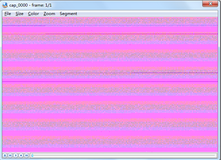

TDA4VM: test with ub962 pattern but get wrong yuv data and WARNING of "CAPTURE:Error frame not provided using tivxCaptureRegisterErrorFrame"
Part Number: TDA4VM
Hi TI,
We try to test the 962 pattern in  R5F rtos (8.0 sdk),  but get wrong yuv data and WARNING of "CAPTURE:Error frame not provided using tivxCaptureRegisterErrorFrame", could you please help?

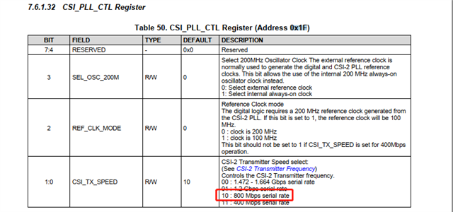

        CSIRX_LANE_BAND_SPEED_800_TO_880_MBPS,//CSIRX_LANE_BAND_SPEED_720_TO_800_MBPS, /*csi_laneBandSpeed*/

imgaddr_width = 1280
imgaddr_height = 800
imgaddr_stride = 2560
width = 1280
height = 800
Written 2048000 bytes
2048000 bytes written to .//cap_0000.yuv

3.View the yuv image in PC
  • Can you please press 'p' on the console? Lets first see if capture is working fine.
    You could ignore error "CAPTURE:Error frame not provided using tivxCaptureRegisterErrorFrame" for the time being.
    Brijesh
  • Hi Brijesh,
    Below is the performance statistics, and our custom board is using the CSIRX_INST_1 to capture the data,  thus I try to change dataLanesMap to {4,5,6,7}, the issue still persists.  And very appreciate for your reply. thanks

    Looking at the register settings for the test pattern output, it looks like you are enabling CSI output from the first register, this must be enabled only during streamon callback. Could you please refer to ti-processor-sdk-rtos-j721e-evm-08_00_00_12\imaging\sensor_drv\src\ub9xx_yuv_test_pattern\ub9xx_testpat_serdes_config.h file and implement it in similar way?
    {0x33,0x03,0x1},//CSI0 enable
    Also i am assuming that lane speed that you are using in the CSIRX configuration is same as output lane speed from ub962.. If not, please change it accordingly.

  • Hi Brijesh,
    I revise the code as your advice, but there is still no capture happening. below is my change:
    1.ub9xx_testpat_serdes_config.h
    we set the ub962 lane speed to 800Mbps, and  set CSIRX_LANE_BAND_SPEED_720_TO_800_MBPS in testpatCreatePrms struct.
