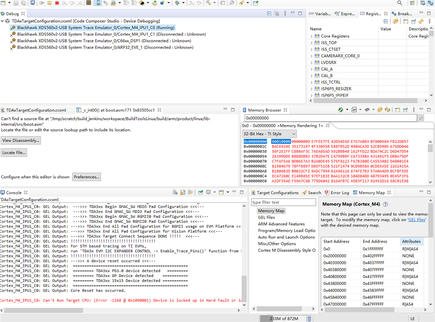

Second, problem phenomenon
1. CCS download environment;
2. JTAG can be connected successfully but cannot be loaded.
PDF according to visionsdk_userguide_tda3xx. PDF and processorsdkradar_userGuide. PDF, we want to download the firmware in QSPI mode and start TDA3x.  The Blackhawk USB560v2 System Trace debugger was able to connect to the target CPU, but failed to load the.xem4 SBL file generated by the compilation:

Cortex_M4_IPU1_C0: File Loader: Verification failed: Values at address 0x83500128 do not match Please verify target memory and memory map.
Cortex_M4_IPU1_C0: GEL: File: E:\ti\PROCESSOR_SDK_RADAR_03_08_00_00\vision_sdk\binaries_2243ES1.0-TDA3x\apps\tda3xx_evm_bios_radar\sbl\qspi_flash_writer\tda3xx-ar12-booster\qspi_flash_writer_ipu1_0_release.xem4: a data verification error occurred, file load failed.
3.Error 0x83500128 is a DDR address. After initializing DDR (CCS - Scripts - DDR Memory Config - TDAxx_DDR3_532MHz_Config), the following error occurs:
4.If you adjust different dip switch modes (visionsdk_userguide_tda3XX. PDF -- 3.4 Boot Mode), the following errors also occur:
The error log is as follows:

Cortex_M4_IPU1_C0: Can't Run Target CPU: (Error -1268 @ 0x1090001) Device is locked up in Hard Fault or in NMI. Reset the device, and retry the operation. If error persists, confirm configuration, power-cycle the board, and/or try more reliable JTAG settings (e.g. lower TCLK). (Emulation package 9.2.0.00002)
