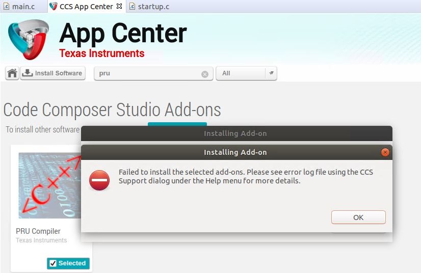

Part Number: AM6548
Hi Ti,
We are using CCS 10.4.0.00006 version and want to download PRU compiler from APP center.
However, It always failed.
Could you help to check it?
Thanks.
Eric
Hello Eric,
This is a known issue:
https://sir.ext.ti.com/jira/browse/EXT_EP-10556
As a workaround, I suggest manually downloading the compiler directly from ti.com:
https://www.ti.com/tool/PRU-CGT
Then install it and have CCS discover it: https://software-dl.ti.com/ccs/esd/documents/ccs_compiler-installation-selection.html#compiler-discovery
