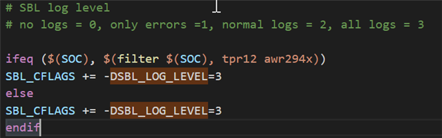

  • Hi Tan Yang,
    Can you please increase the log level in SBL from <pdkInstallPath>\packages\ti\boot\sbl\sbl_component.mk and share the logs while booting your multi-core image?
    Parth
  • Hi Parth Nagpal,
    I have changed the log level to 3 as the following figure.
    Then, I perform the command make sbl_mmcsd_img again  and copy the sbl_mmcsd_img_mcu1_0_release.tiimage to SD card as tiboot3.bin .
    However, I still see any other useful information  while booting my multi-core image.

  • Hello Yang,
    Happy New Year to you as well.
    I think you had earlier similar issue, with combined appimage of mcu1_0, mcu2_0 and mcu2_1 and then you were able to get it working after fixing memory map.. Are the same changes applied here also?
    Can you narrow it down to further which core is not booting, by incremental adding one core at a time in app, and then check memory map of this core?
    You could even try to enable/increase log level in SBL to see what is happening in SBL. One more question, is SciServer integrated with mcu1_0 binary?
    Brijesh
  • Hi Brijesh Jadav,
     I have changed the link file of mcu2_1 as you said before. Move the origin of MAIN_MSRAM_0 to 0x70100000 in the file.
    I want to know what is special about the address 0x70100000, why we need to offset the address here?
    I tried to generate the .appimage of mcu1_0.rprc.
    The combined appimage composed of mcu1_0.rprc and the binary file app_remoteswitchcfg_server.xer5f of mcu2_0.
    The combined appimage of mcu1_0.rprc and mcu2_1.rprc.
    And the combined appimage of mcu1_0, mcu2_0 and mcu2_1.
    The result is that as long as app_remoteswitchcfg_server.xer5f of mcu2_0 is added, booting from the SD card will not succeed
    So use the app_remoteswitchcfg_server.xer5f of mcu2_0 in the SD card. Is there anything to pay attention to?
    I upload the map files of mcu1_0, mcu2_0, mcu2_1 and the serial port log when I boot the combined appimage of mcu1_0, mcu2_0 and mcu2_1 from the SD card.
    Please help me analyze the problem , thank you very much.
