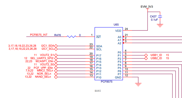

  • How is the AM5708 part detecting an attached device? For Micro-AB connectors, this is done through the USB_ID signal.  Since AM5708 does not have a detected USB_ID input pin, detection is done either with a GPIO pin or with an I2C connection reading from a bus expander, as is the case on the AM5708 EVM:
    I see that in your above schematic, you are using a type C connector.  In that case, the CC lines take the role of determining connection status as well as cable orientation.  Since AM5708 can't handle that, some external circuitry is needed to convert the CC pins into an equivalent "USB_ID" signal.  But I see both CC pins on the connector are tied together.  The signal exits the image at the top right.  So how are these signaling to the AM5708 that a device is connected?
