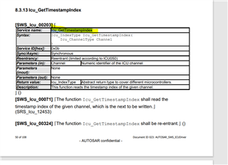

Update the function name Icu_GetTimeStampIndex
For MCAL
ti-processor-sdk-rtos-j721e-evm-07_03_00_07,
In the Icu module the Icu.c file at line no. 560 ,
has the function Icu_GetTimeStampIndex name as Icu_GetTimeStampIndex
but as per AS431 (refer attched screenshot)
the name should be Icu_GetTimestampIndex
Due to this mismatch there is an issue during compilation.
Refer the EB_update file after the update the compilation is fine.

ICU_FUNC_TEXT_SECTIONFUNC(Icu_IndexType, ICU_CODE) Icu_GetTimestampIndex(
    Icu_ChannelType Channel)

the function name should be updated as defined in AS431 document.
Please let us know regarding this update.

  • Hi Kamia,
    I see this mis-spelling as well in 7.3 SDK, and even later SDKs.
    Currently, it is not generating a compilation issue because it is not used in the example application, I assume you have an app that used it and you found the error.
    I have raised a bug for this, reference number - MCAL-7962.
    Erick
