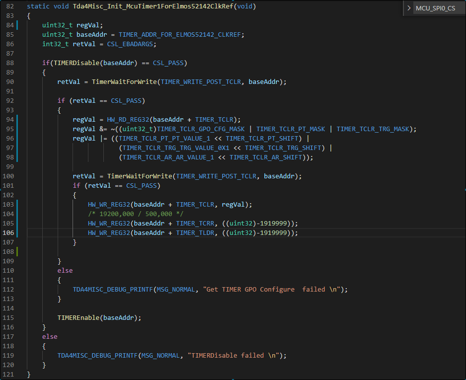

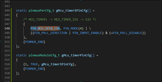

The following is my configuration code, the timer is running, but the pin E25 does not output pulse.
