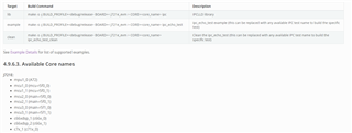

We use tda4 evm , compile IPCLLD test ,but it can not compile correctly
we use command as follow:
Thank you very much for your help.

You need to add OS type with the APP_NAME while giving build command. Please try the following command from PDK/packages/ti/build
make BOARD=j721e_evm CORE=c66xdsp_1 ipc_echo_test_tirtos
