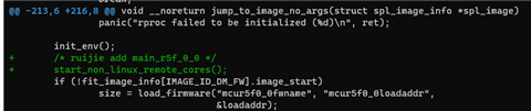

we just use the SPL+UBOOT ways to start up the TDA4vm。
in  tiboot3 SPL, we load j7-mcu-r5f0_0-fw firmware and tispl.bin image.
And in uboot,we load c66 and c71 firmware by rproc.
Now,we would like to load c66 and c71 firmware in tiboot3 spl,
I don't know if it can be achieved by rproc or spl_emmc_load,Are there some articles for reference?thanks.
