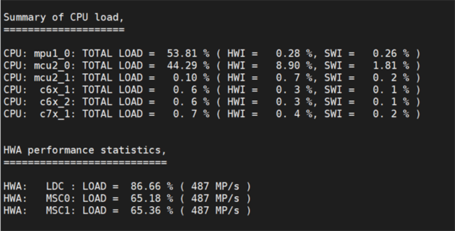

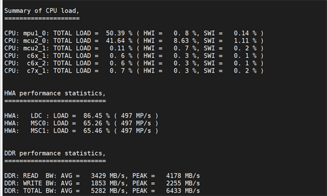

After app_multicam is running. we run another apps which read I2C register peroidly by remote service at backgroud, frame drop counter increas almost every remote-service call.

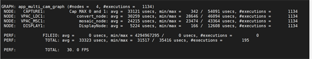

performance log with multicam only:

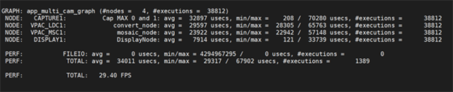

performance log with multicam and backgroud app:
It seems HWA performance drop from 497MP/s to 487MP/s,and average execution time increas from 33333us to 34000us
What might be the cause of the performance degradation?
