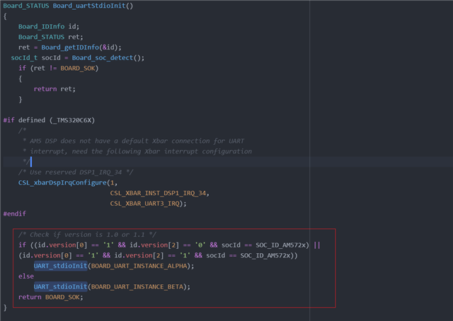

1) Refer to UART_stdioInit API in PDK\packages\ti\drv\uart\src\UART_stdio.c.
UART_stdioInit basically initializes the UART instance to use for console operations and also initializes UART_Stdio_Object.
You need to create two UART_Stdio_Object 1) uart_stdio_read, 2)uart_stdio_write
2) Write two more API's similar to UART_stdioInit - (UART_stdioInitRead and UART_stdioInitWrite) to initialize uart_stdio_read and uart_stdio_write.
3) Modify Board_uartStdioInit in PDK\ti\board\src\idkAM572x\idkAM572x_lld_init.c to call UART_stdioInitRead and UART_stdioInitWrite with respective instances instead of UART_stdioInit.
4) Modify uart_console_getc and uart_console_putc in PDK\packages\ti\drv\uart\src\UART_stdio.c to pass respective read and write handles to UART_write and UART_readPolling.
