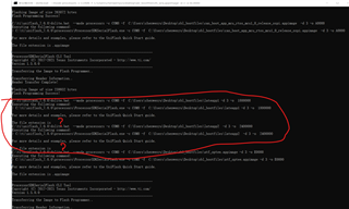

when i  exec make qnx_fs_install_ospi in ubuntu pc , error occured, change to Windows PC and flash used below command:
C:\ti\uniflash_7.0.0\dslite.bat --mode processors -c COM8 -f C:\ti\uniflash_7.0.0\processors\FlashWriter\j721e_evm\uart_j721e_evm_flash_programmer_release.tiimage -i 0
C:\ti\uniflash_7.0.0\dslite.bat --mode processors -c COM8 -f C:\Users\chenwenyu\Desktop\sbl_bootfiles\sbl_cust_img_mcu1_0_release.tiimage -d 3 -o 0
C:\ti\uniflash_7.0.0\dslite.bat --mode processors -c COM8 -f C:\Users\chenwenyu\Desktop\sbl_bootfiles\tifs.bin -d 3 -o 40000
C:\ti\uniflash_7.0.0\dslite.bat --mode processors -c COM8 -f C:\Users\chenwenyu\Desktop\sbl_bootfiles\can_boot_app_mcu_rtos_mcu1_0_release_ospi.appimage -d 3 -o A0000
C:\ti\uniflash_7.0.0\dslite.bat --mode processors -c COM8 -f C:\Users\chenwenyu\Desktop\sbl_bootfiles\lateapp1 -d 3 -o 1800000
C:\ti\uniflash_7.0.0\dslite.bat --mode processors -c COM8 -f C:\Users\chenwenyu\Desktop\sbl_bootfiles\lateapp2 -d 3 -o 2400000
C:\ti\uniflash_7.0.0\dslite.bat --mode processors -c COM8 -f C:\Users\chenwenyu\Desktop\sbl_bootfiles\atf_optee.appimage -d 3 -o E0000
C:\ti\uniflash_7.0.0\dslite.bat --mode processors -c COM8 -f C:\Users\chenwenyu\Desktop\sbl_bootfiles\ifs_qnx.appimage -d 3 -o 6C0000
Question1:
lateapp1 and lateapp2 can not flash, but rename lateapp1 to lateapp1.bin(add extension),blow command can be exec successful.  please give me some suggestions?

    Q1: When specifying the filename to be flashed, the full path and full filename are required.   In the linux build the generated files are "lateapp1" and "lateapp2'.  In windows envrionment if the .bin extension is present on the generated files, then it should be included in the filename.

  • Q1.
    in ubuntu pc, flash ospi flash failed, so i copied sbl_bootfiles from ubuntu to window pc,
    lateapp1 and lateapp2 are full name, the two files flash failed .
    so i change the filenames to lateapp1.bin and lateapp2.bin, just for test, then the two files flash success.
    why?
    thanks!
    Q2.
    the addresses of OSPI all are wrong , i change the address, OSPI+SBL boot success.  you should update the file makefile_sbl.mak.
    OSPI_LOCATION_SYSTEM_BIN=XXX
    OSPI_LOCATION_BOOT_APP=XXX
    thanks!
